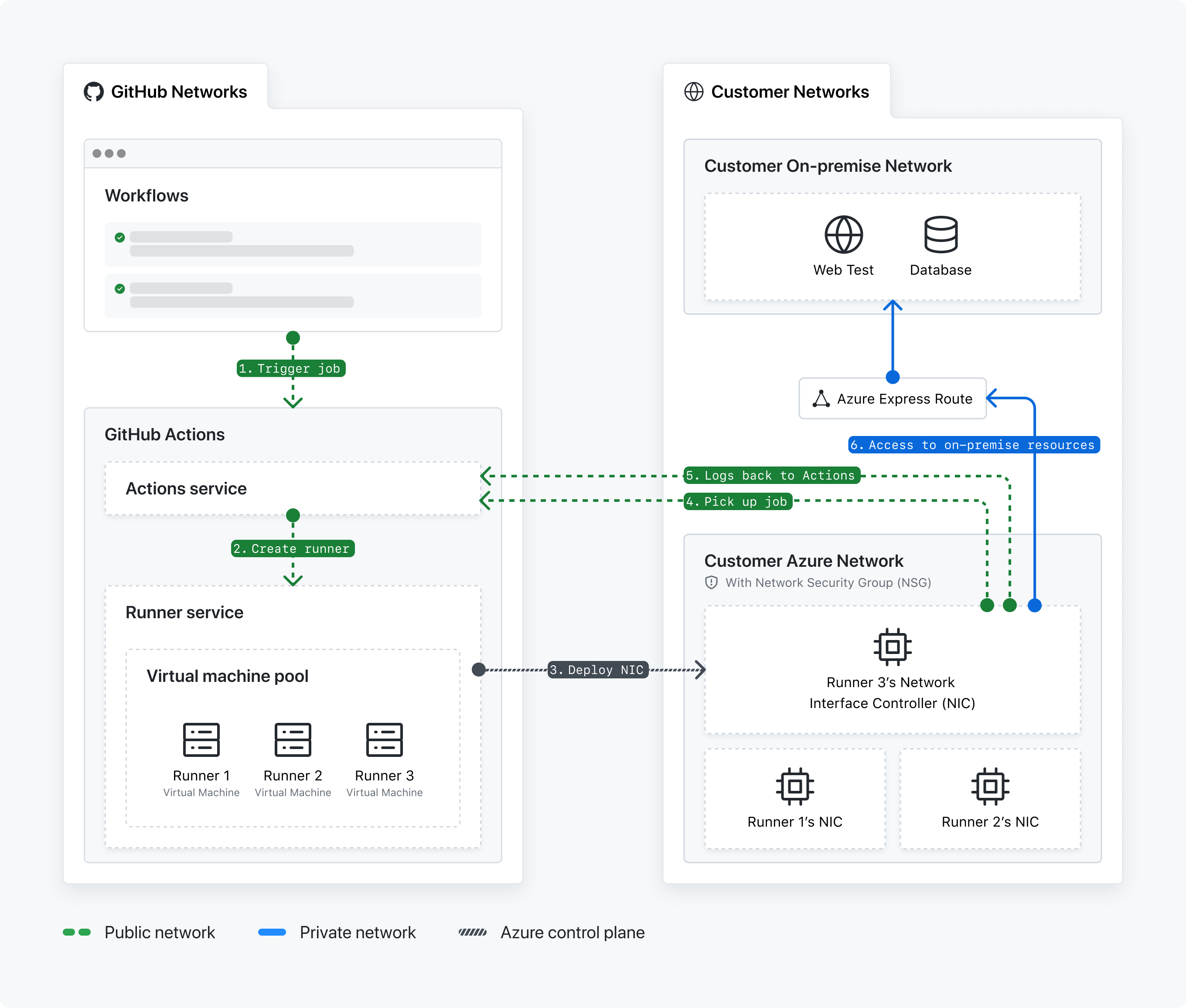

To facilitate communication between GitHub networks and your VNET, a GitHub-hosted runner's network interface card (NIC) deploys into your Azure VNET.
Because the NIC lives within your VNET, GitHub cannot block inbound connections. By default, Azure virtual machines will accept inbound connections from the same VNET. For more information, see AllowVNetInBound on Microsoft Learn. It is recommended to explicitly block all inbound connections to the runners. GitHub will never require inbound connections to these machines.
A NIC enables an Azure virtual machine (VM) to communicate with internet, Azure, and on-premises resources. This way, all communication is kept private within the network boundaries, and networking policies applied to the VNET also apply to the runner. For more information on how to manage a network interface, see Change network interface settings on Microsoft Learn.
Note
Multiple NICs may appear for a single job in your subscription because the GitHub Actions service over-provisions resources to run jobs. Once a runner is idle, the GitHub Actions service automatically de-provisions the resource and removes the corresponding NIC.
Diagram of network communication between GitHub and your private networks. Each step is numbered and corresponds to a step listed below the diagram.
  1. A GitHub Actions workflow is triggered.
  2. The GitHub Actions service creates a runner.
  3. The runner service deploys the GitHub-hosted runner's network interface card (NIC) into your Azure VNET.
  4. The runner agent picks up the workflow job. The GitHub Actions service queues the job.
  5. The runner sends logs back to the GitHub Actions service.
  6. The NIC accesses on-premise resources.
